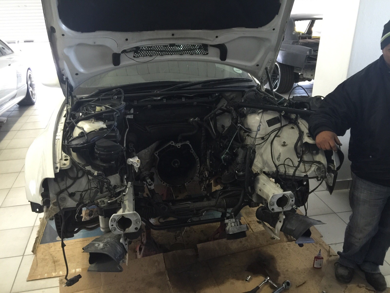

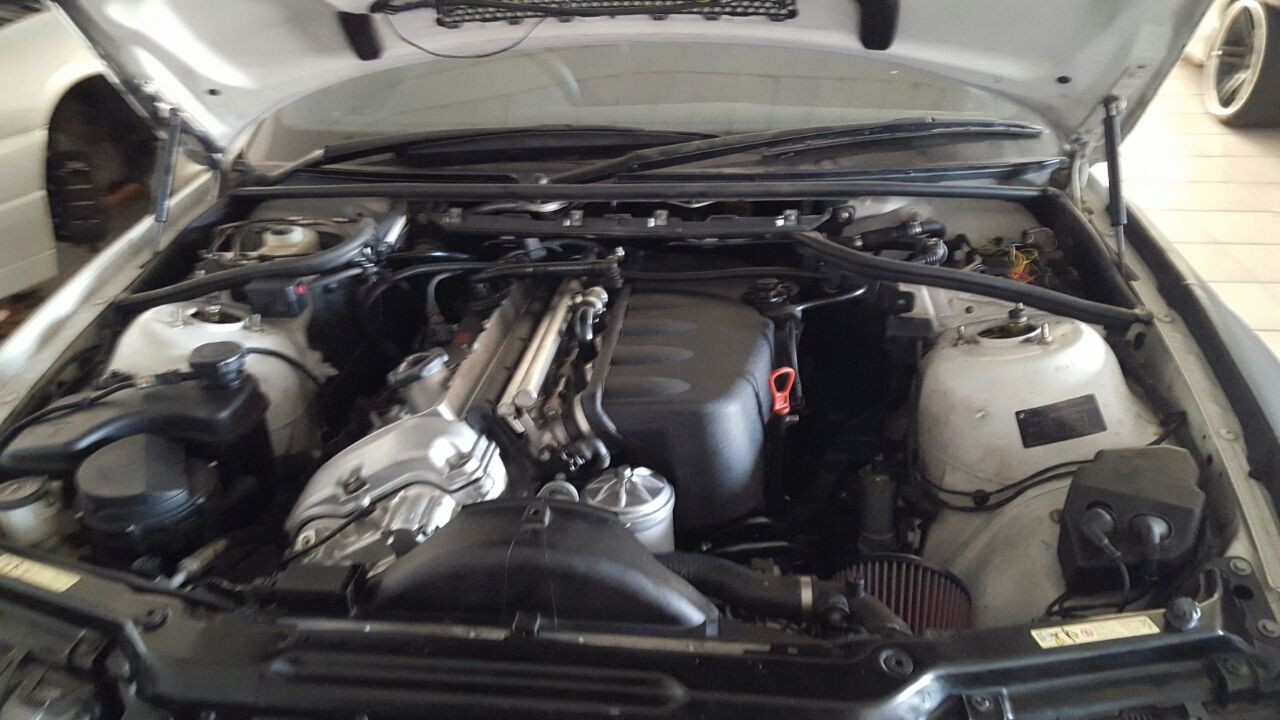

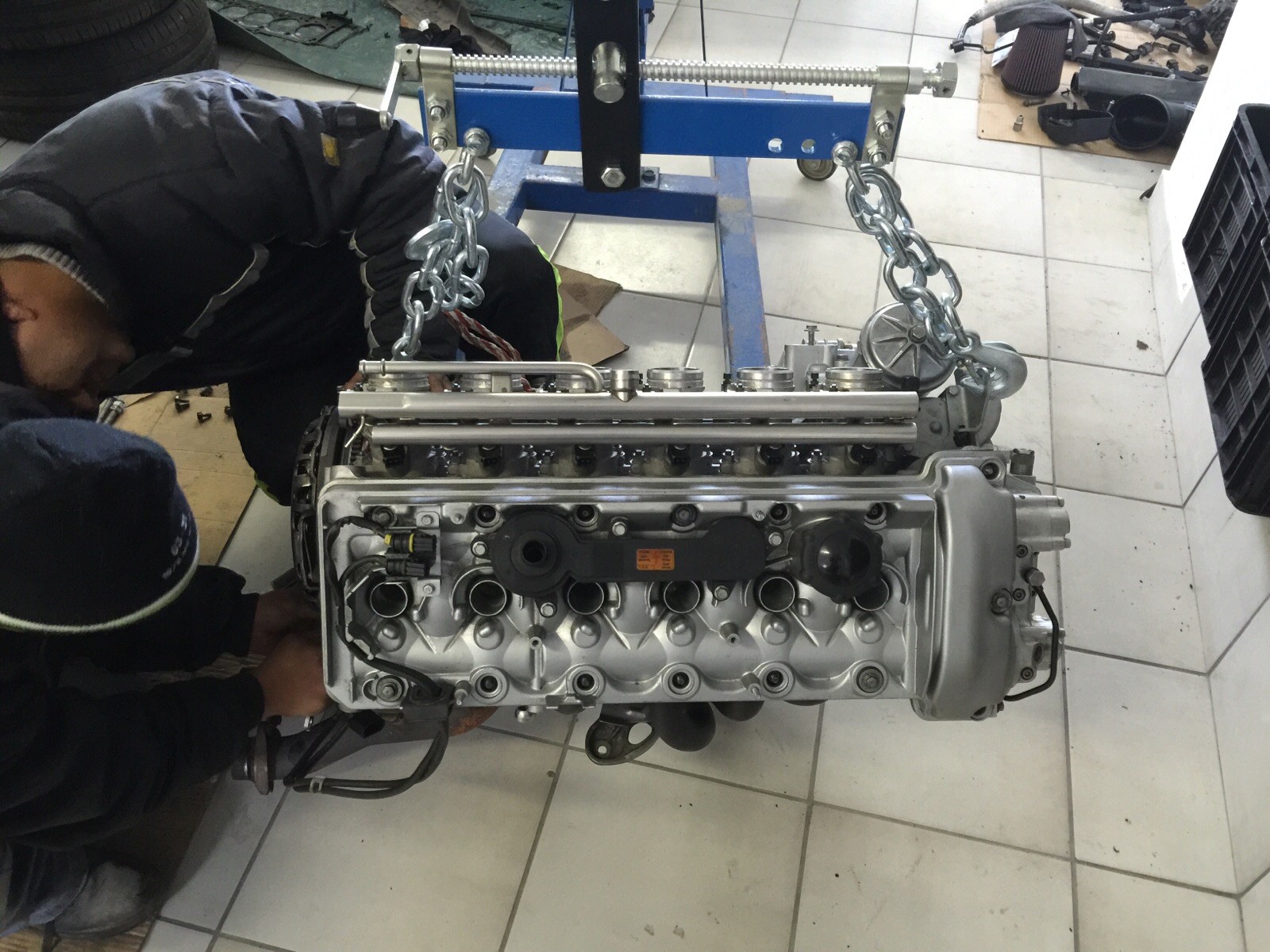

This baby was sent to the tuners for a tune and new camshaft, but they put in the incorrect rocker arms which caused massive damage to the cams. They then, upon an attempt to fix, incorrectly reassembled the head which caused the car to go into limp mode. It was over-fueling and it caused bore wash, and the ridge in the block was badly worn.

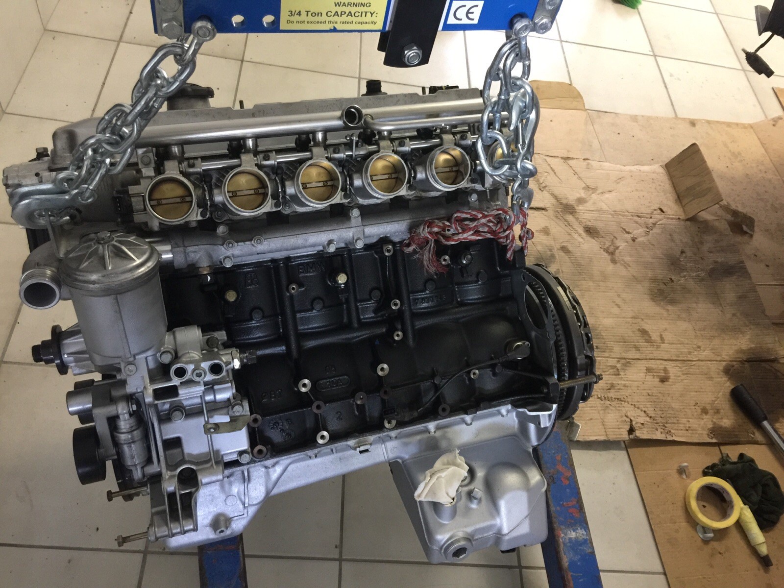

So, we've done a complete strip down of the motor for repairs and reassembly. New rings, cams, valve stem seals and other wear items. New cam shims installed; the head needed cleaning after the incorrect oil was used; bearings needed replacing after the bore wash from the over-fueling; etc.
The new engine is now assembled and in place; the cam clearances just need to be confirmed. After this, the software will be flashed back to stock and we will look at new options and the next steps to take.
The rear quarters are in for a respray.
Some pichaaas:

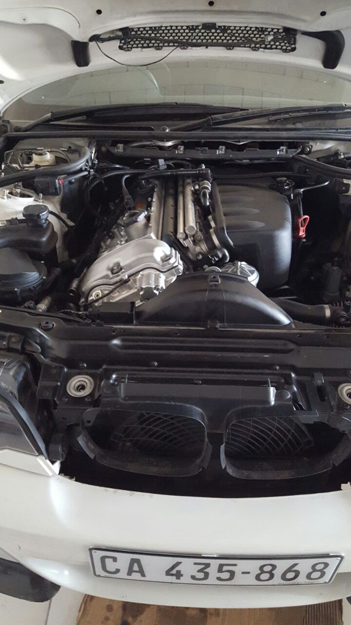

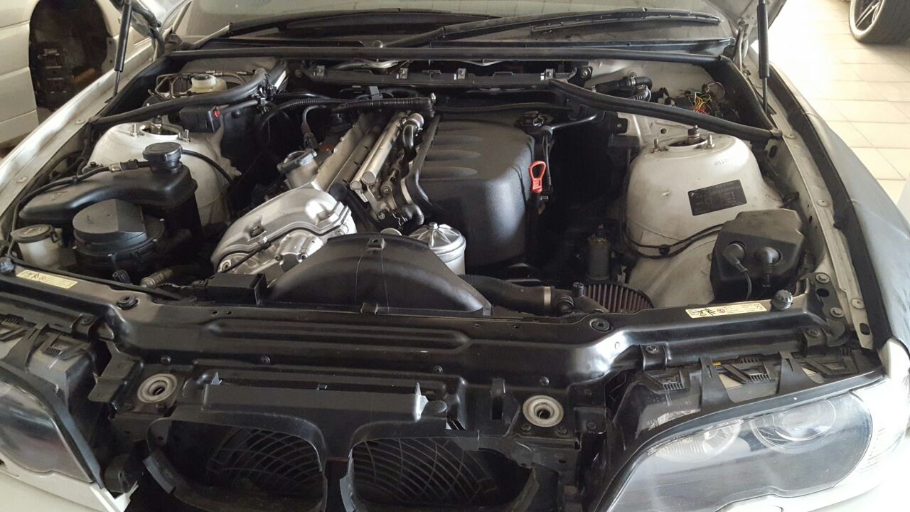

Small update:
The engine is in. All that's left to attend to is the ignition, induction, and all the bits and bobs some folk like to refer to as "smalls" ;)
Yes yes, we know you love pics :rollsmile:
