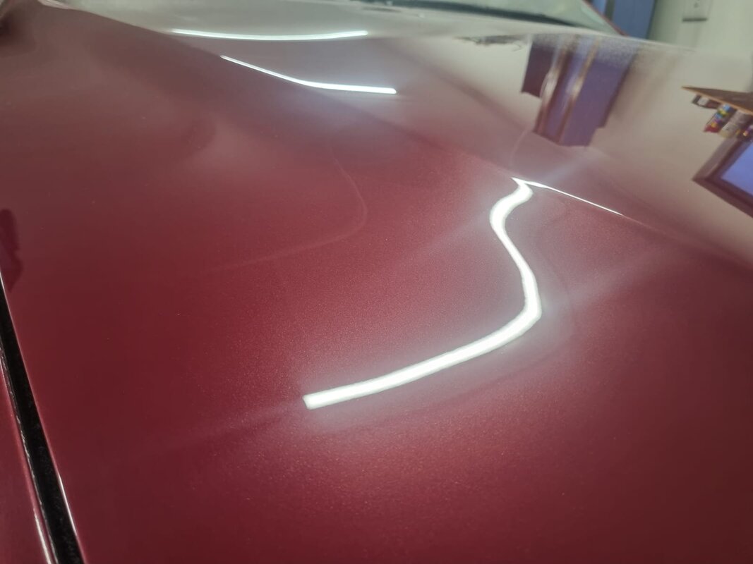

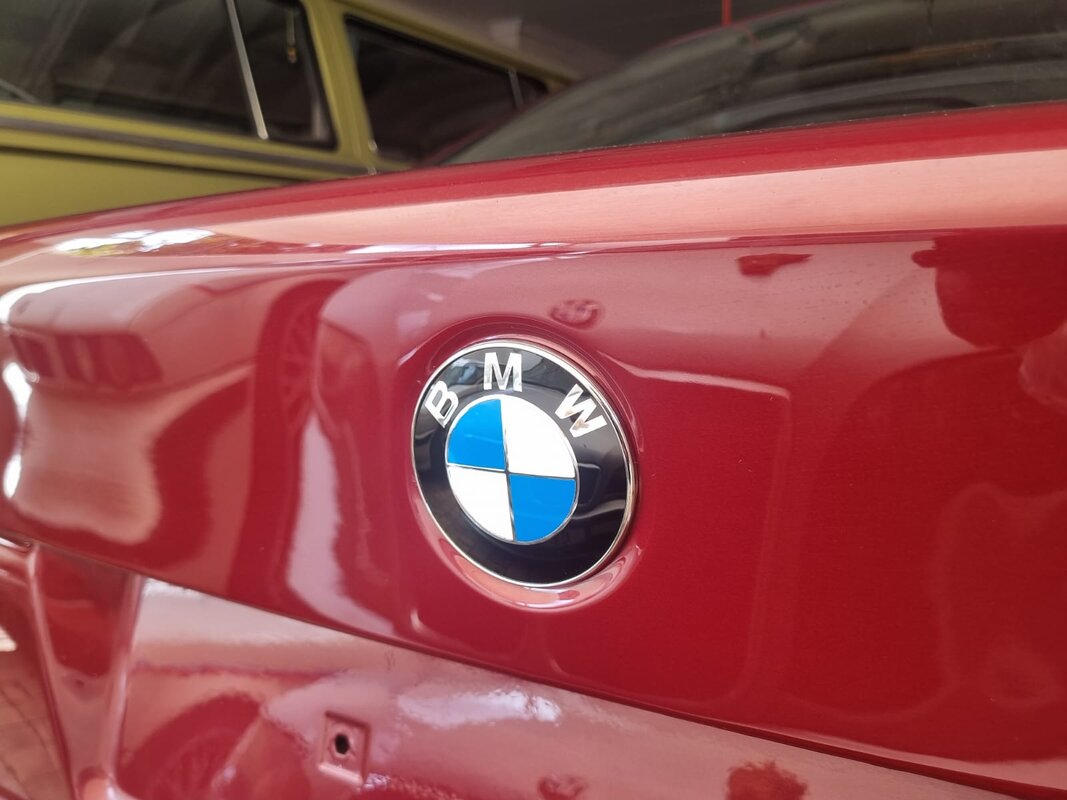

After countless hours of mind numbing wet-sanding and polishing of paintwork, I shifted focus to the fun stuff - mechanicals.

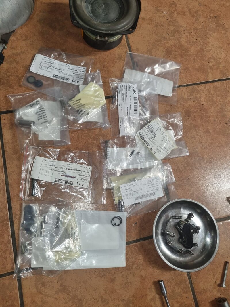

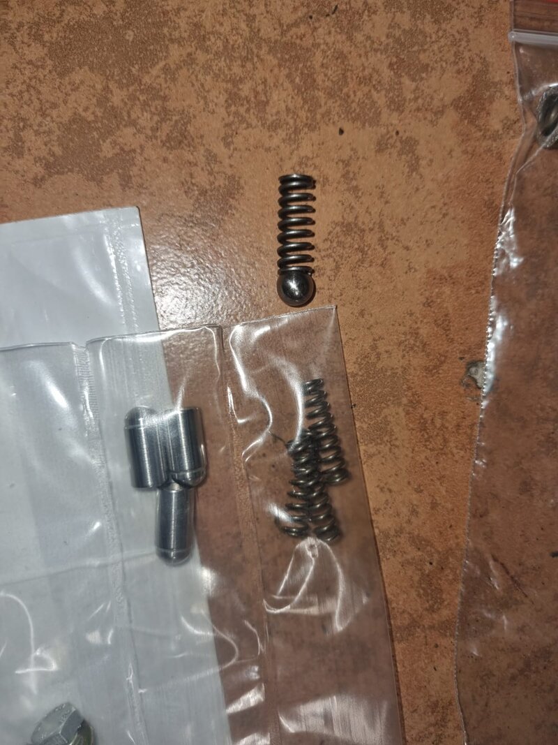

I replaced the gearbox detent pins, lock pins and oil seals. It was a bit nerve wracking at first, but I took my time and enjoyed the process. The old style detent is a ball and spring vs later one with a rounded sleeve and spring.
Note the beefy Z4 speaker which acted as the magnet to remove the balls and pins

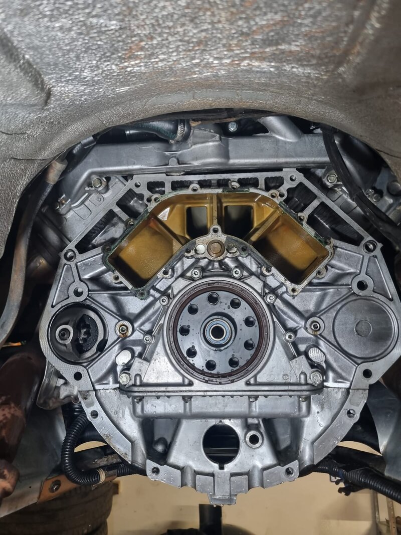

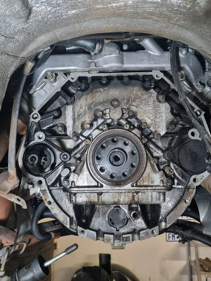

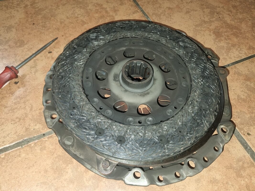

Remove the flywheel to reveal a pathetically weeping rear main seal. Did the right thing and replaced the rear coolant cover while I was in the postal code.

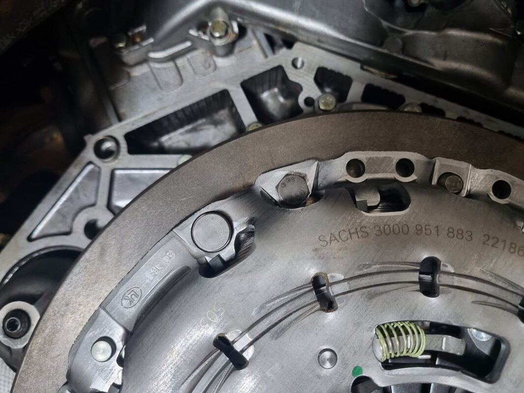

Of course the original clutch was a bit tired
Installed a new LUK clutch that came in a Sachs box and stamped with both brands - weird, but a nice surprise! New release bearing, clutch pivot pin and fluid flush.

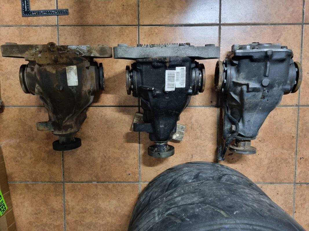

Onto my continued obsession with diffs...from left to right, E39 540i (2.81 open), E39 M5 (3.15 LSD) and E32/E34 (3.15 open).
The M5 diff bolts into the 540i provided you use the E32/E34 output flanges and the M5 propshaft. Note how the M5 diff is the same as the E34 diff, just the front mount is a bit different. Slapped it all in with the customary new centre support bearing and guibo. I also installed the M5 rear stabilizer bar to compliment the LSD and tighten up the handling a bit.

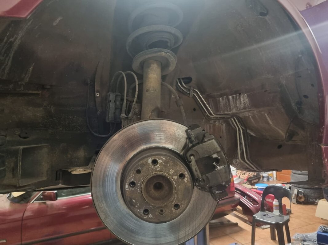

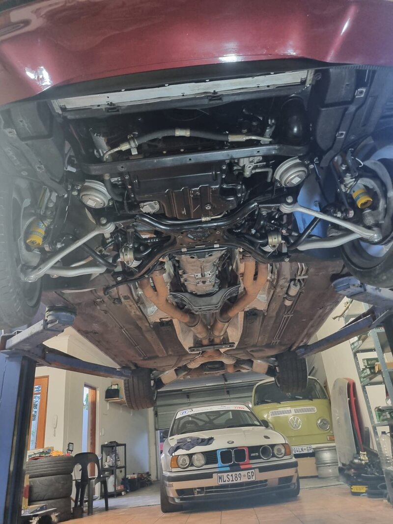

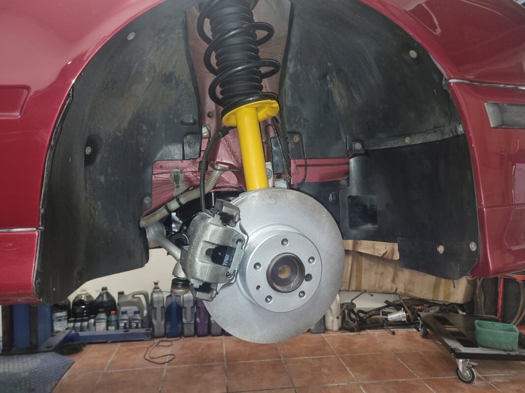

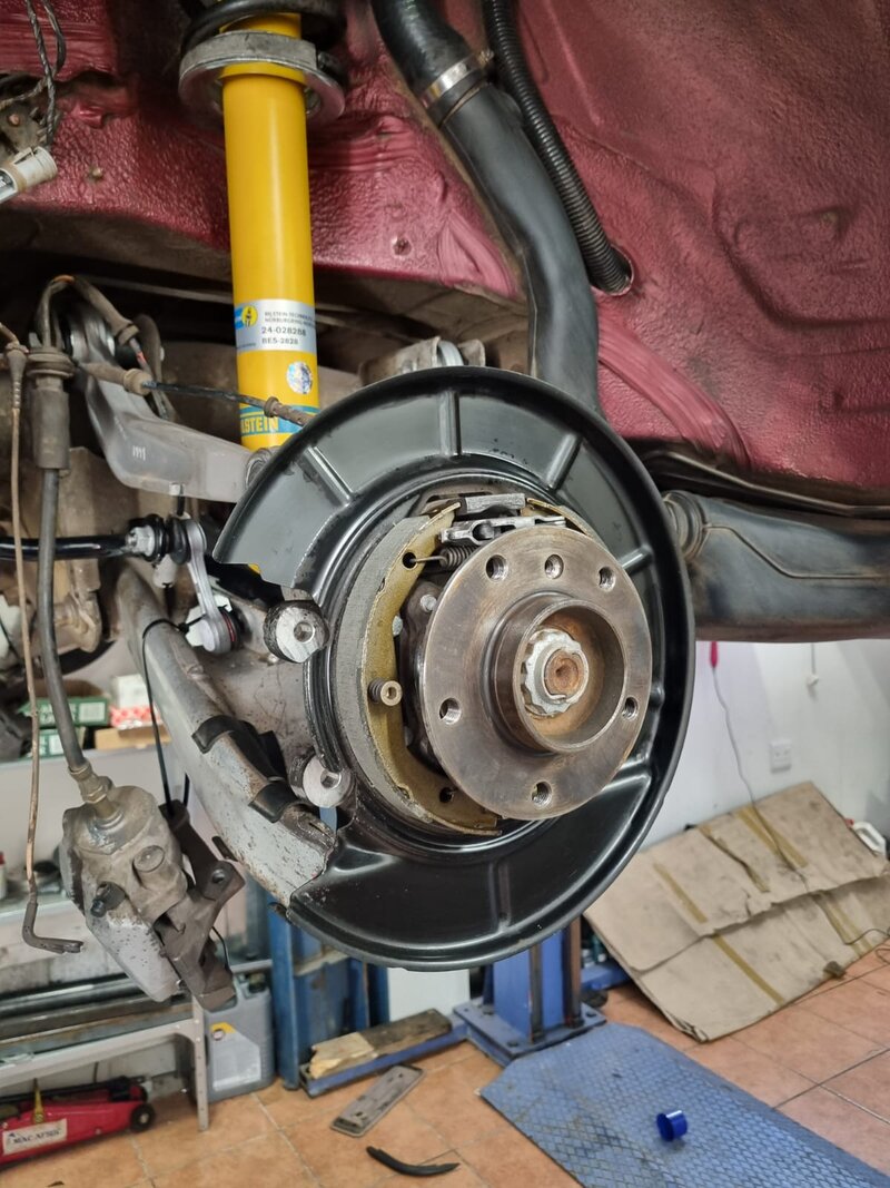

Engage my finest use of zulu, afrikaans and german fowl language to replace the complete suspension. Also, honorable mention to the sadistic dimwit who designed the rear shock mounts access which necessitate removing the whole rear interior as well as the subwoofer! I'm sure he (she?) is the same nitwit who designed the E34 cabin air filter.

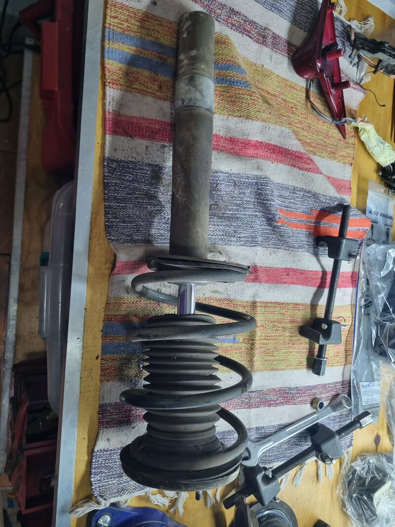

Out with the old:

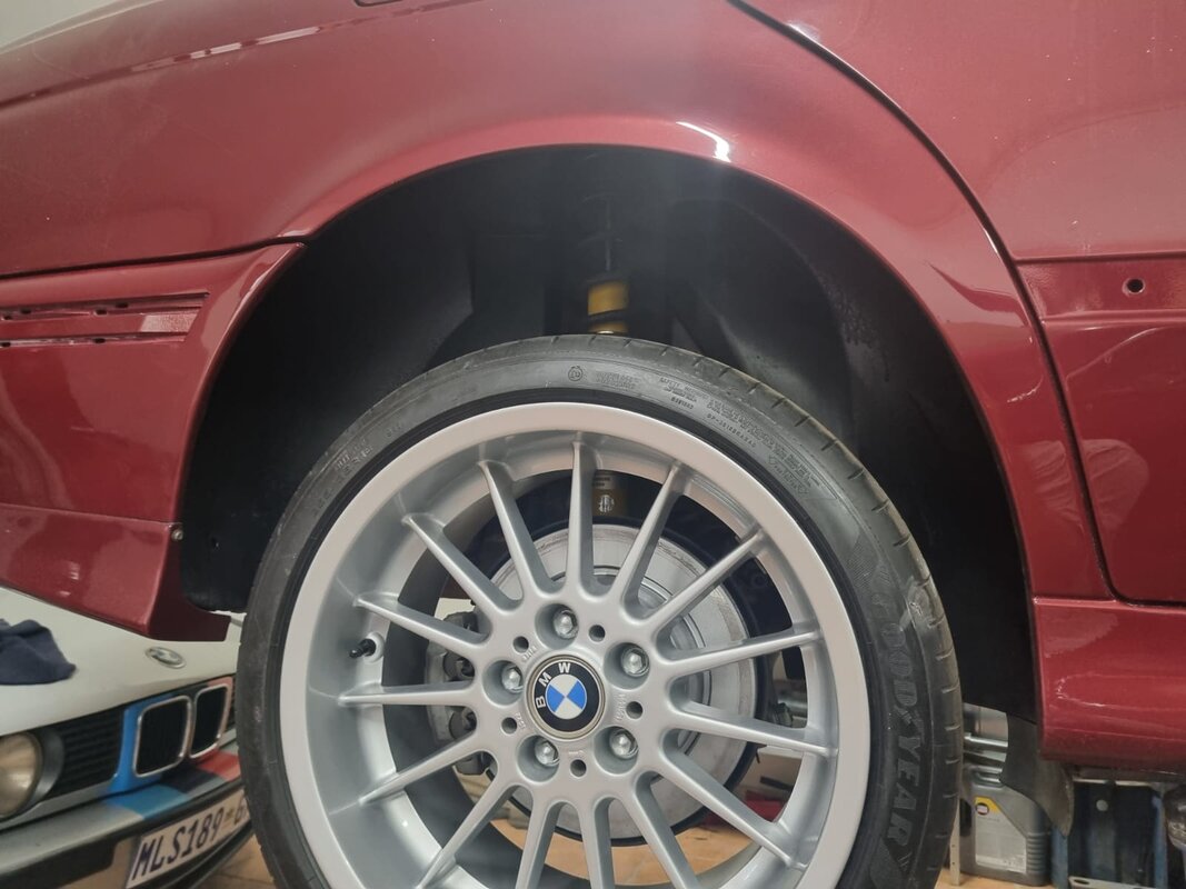

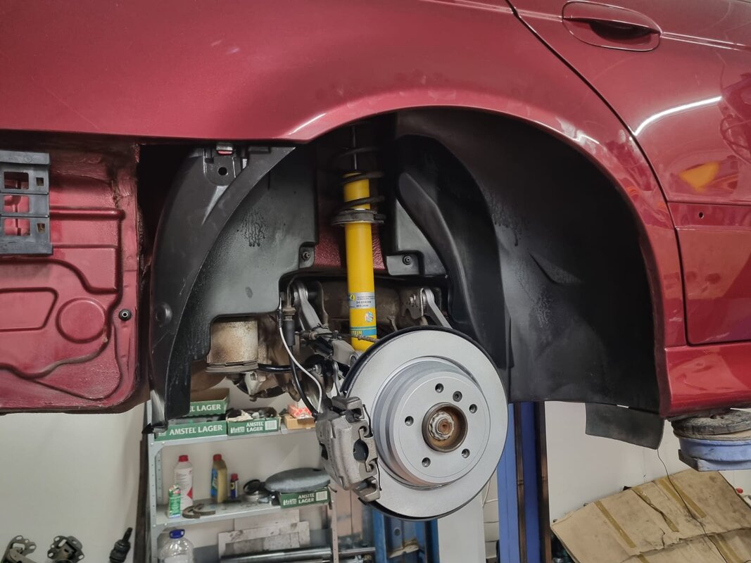

In with Bilstein B6 with new everything including dust cover and spring mounts. Note how much more spring travel the Bilsteins allow...weird.
New discs, pads, wear sensors and handbrake shoes

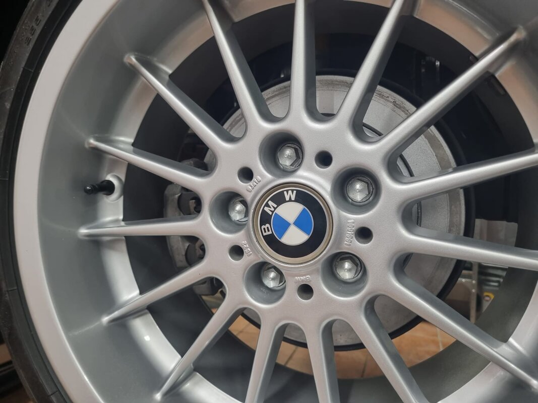

Gave the wheels a little detail and seal:

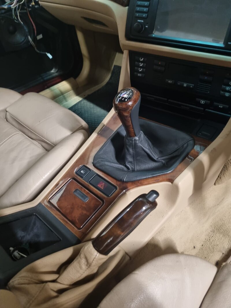

New gearknob and M5/Individual wood trim for the handbrake

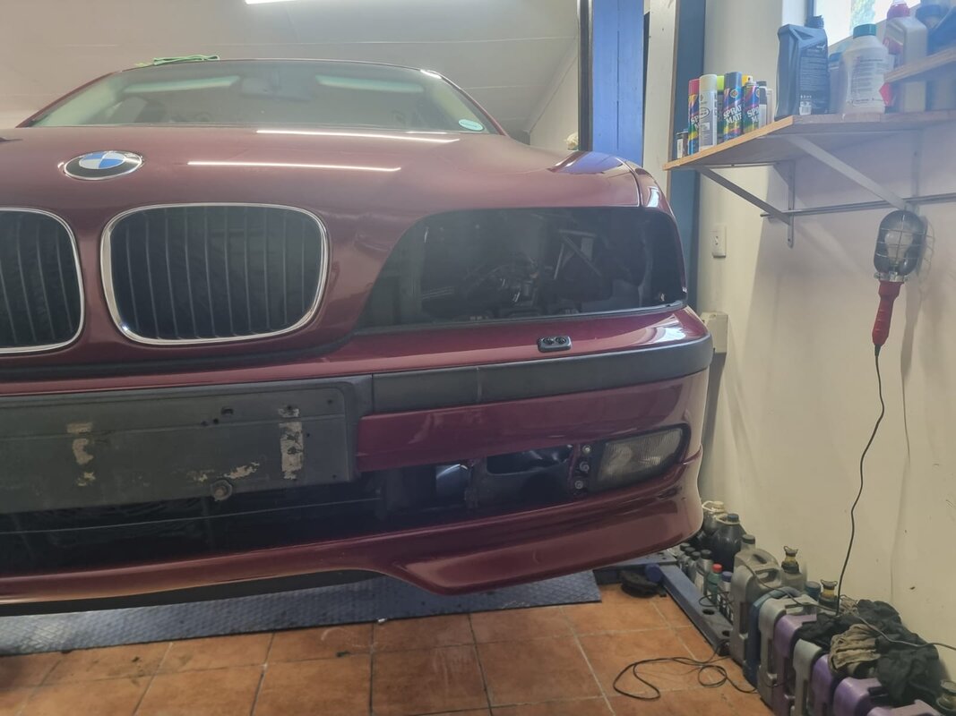

Sneak peak of the first time this car has had its front spoiler on...getting exciting now!

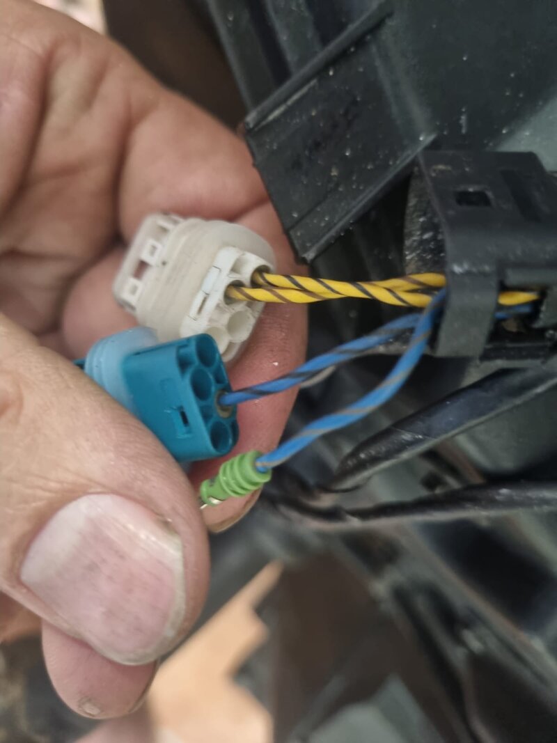

Had to re-plug a few of the headlight plugs which had broken clips, about R50 per plug, but pretty easy to do

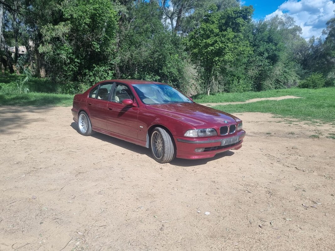

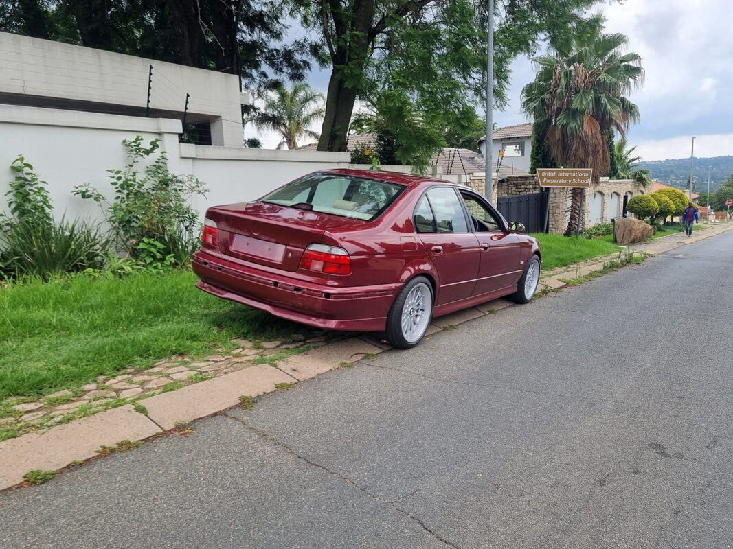

Did the wheel alignment and sorted out a few niggles. Immidiately got the car dirty by driving in the rain and "stress testing" it on the quiet highways...this car pulls like an absolute train with the M5 diff which effectively gives me 10% more power at all times. It was still pulling strong at twice the national speed limit. The motor sits at 2500rpm at 120kph, still a very relaxed cruising speed for the V8. The wet roads afforded plenty opportunity to test the LSD...it works :devilish: The stiffer rear anti-roll bar has also tightened up the handling, the car feels a bit more eager to turn in - but that could also be the WHOLENEW SUSPENSION lol
Still one of the best BMW designs...

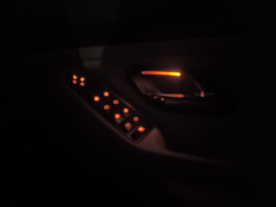

In the interest of wasting money, I sourced some E38 illuminated door handles which really should have been included with the car from factory. Makes it a lot easier to find the door handles at night and brightens up the rear as there is no lighting at all back there, except for the window switches...

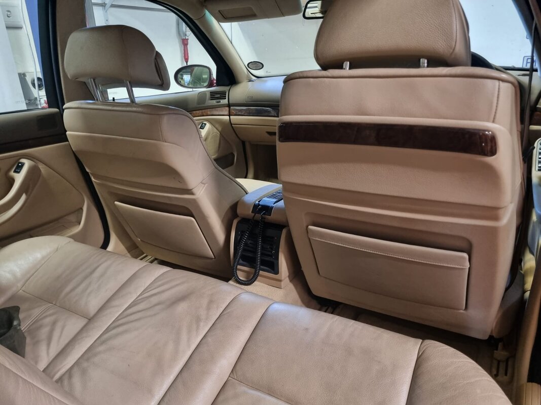

I got a bit lucky and found a set of 750iL extended leather & wood trim seat backs which clip straight onto my "standard" comfort seats. What is better than wood? More wood! And leather ofcourse. Fantastic waste of money, but hey, I can now say that 5 pairs of seats have given their life to make my one, admittedly awesome pair. Frankenstein concoction of E39 comfort & sport, E60 comfort and E38 "highline"
Excuse the dirty interior...

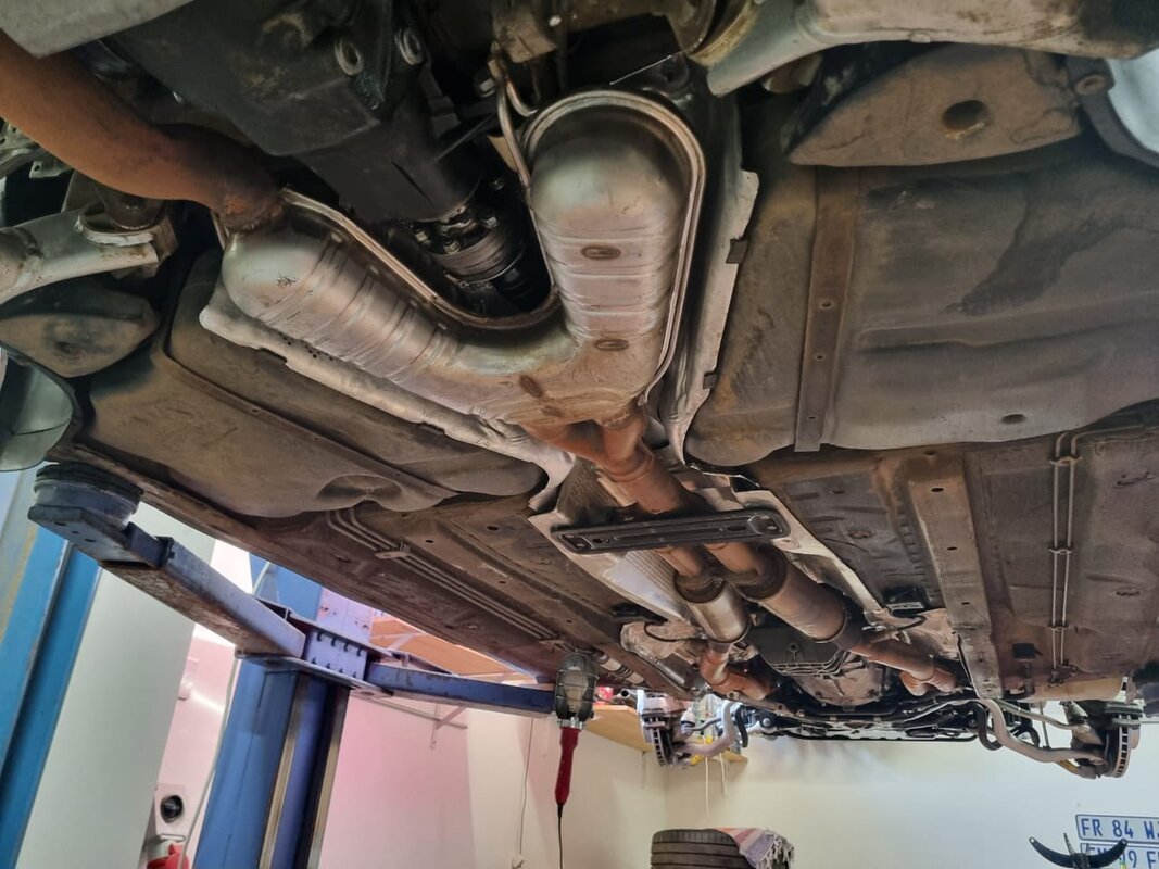

Anyway, moving onto real problems; I had a bit of a shudder from the propshaft between 80 -120 and there was a weird clinking sound when changing gear which turned out to be play in the rear "CV" joint on the propshaft. After much gnashing of teeth, I got my propshaft rebalanced and the CV replaced. Much better but perhaps not perfect.

I used Sajco, but I will not use them again in the future. This is after I had a shudder in the E34 M5 after they "balanced" that prop, and now again with the 540i. They insisted that the shudder is from my diff and the play in the CV is normal. I then took the car to a few different experts and they all pointed to the prop. A diff doesnt shudder and clink, it whines and clunks. To be fair, they did then rebalance and replace the CV at no cost to myself, except the labor and swear jar contributions to remove and replace the prop. The balancing is still not 100% but I have learnt to lower my standards.
The irony in all this is I could have bought a brand new OEM propshaft complete with guibo and center support bearing for about the same money as Ive spent on my prop...so one learns
