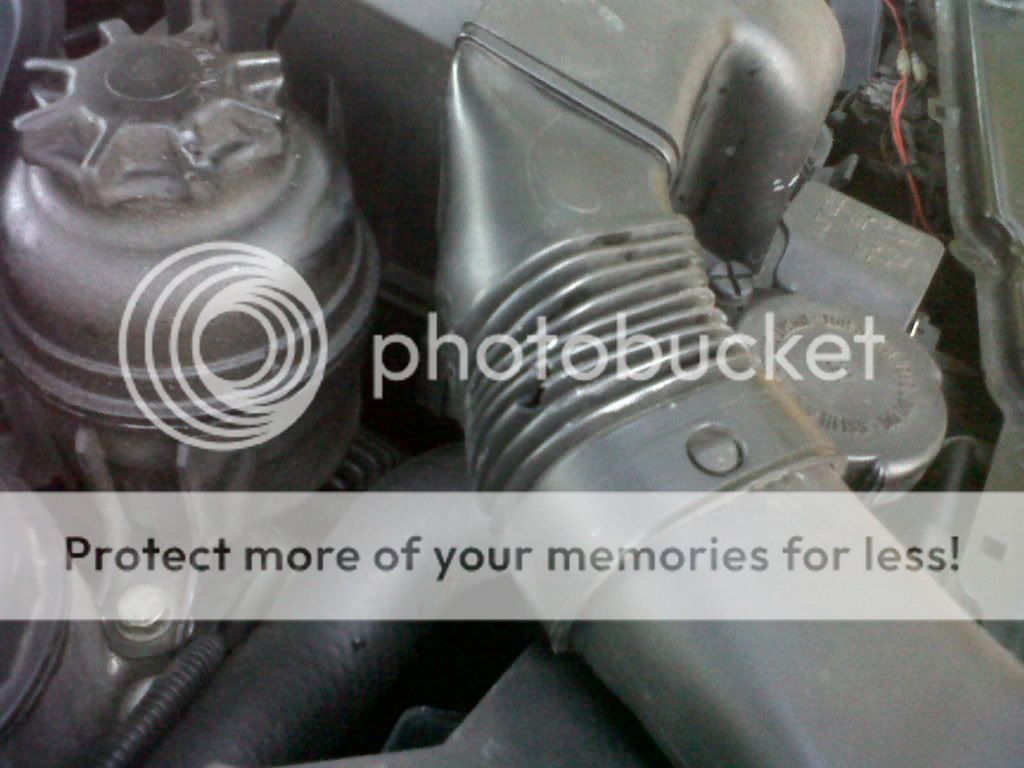

And i don't know how all of us missed it when i opened my bonnet at the dyno day but after inspection found this hole in the intake snorkel. So it was sucking in hot air all day.

Gonna get the air snorkel repaired this week and then hit the dyno. I know as a car fanatic i shouldve checked these things before hand. My minds in another place at the moment and i was just too excited for the dyno day.

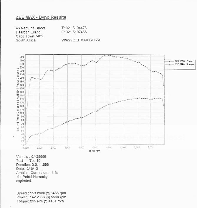

The car feels okay, thats what worries me but to be honest there where times this weekend and especially today where the car felt asthmatic. Only some diagnostics and dyno runs will be able to tell.
Another thing Mike is because i drive medium distance each day with traffic you don't notice these things like i use to when i was doing short trips where i loved to give it full throttle now and then.
The building up slow could be attributed to the air filter building up grit over time and the engine only suffering with hot air in the afternoons because the car is dead cold in the mornings when i drive. And i get most problems when its afternoon driving back.

yeah but the zickzack is terrible :thumbdo:
Yes with regard to the Torque curve. Power curve looks stable enough. Any advice how to get it smoother again? Retune?
