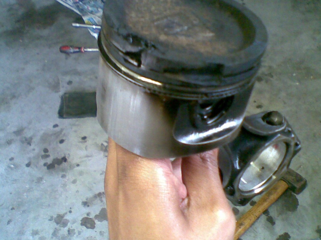

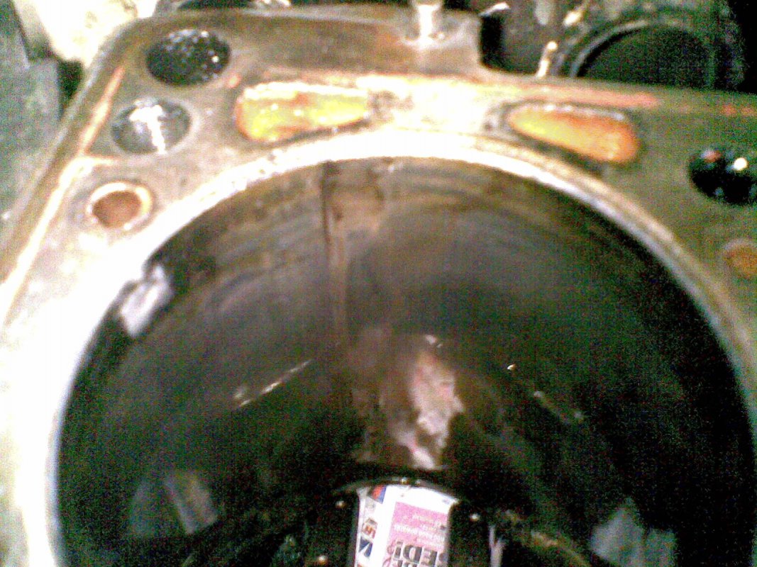

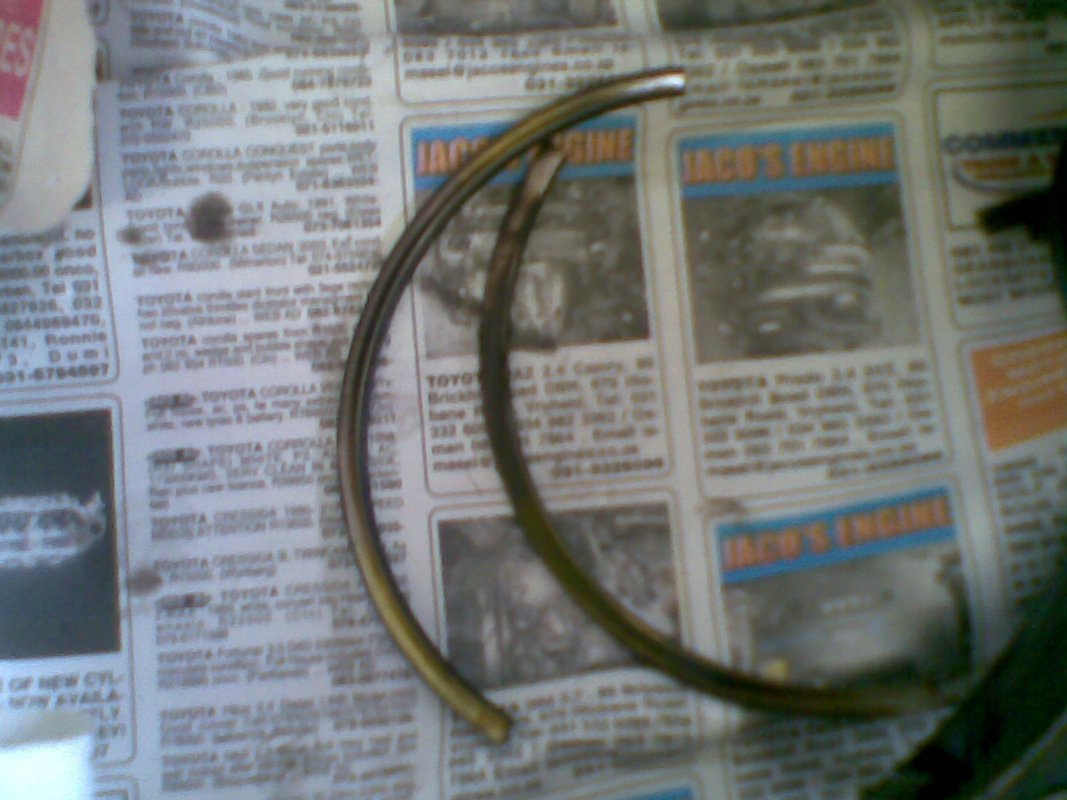

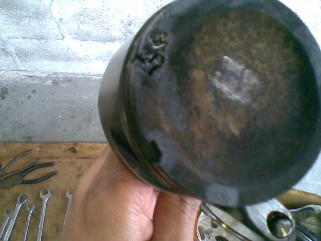

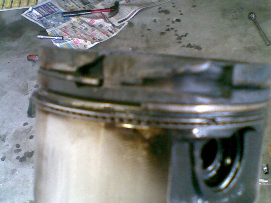

I cracked/Broke a Piston ring in my golf back in the day.
When you removed the oil filler cap, Smoke would Push out of it in droves due to Oil bypassing the piston
And, there was a Slight tapping noise from the engine
Here is an Image of what it caused And the Damage to the Cyl
So no, There is no temp fix and you would have signs you can see, without opening the sump, that something is wrong
