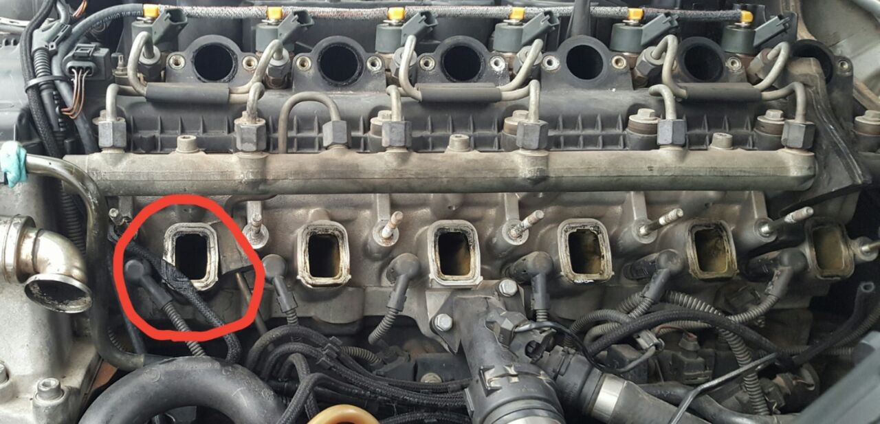

Hi all,
Thank you to all who helped out and gave advice, I really appreciate it. Just to give everyone an update, a very delayed update Haha.:roflol:
After a lot of searching I found out there was a turbo leak on the system. I did this by checking the running pressures inside the manifold using a diagnostic flight mode tool. When I checked the pressures it was getting a max of 0.4 bar at very high rpm's which is why I assumed a turbo leak... I took the turbo pipe off at the turbo and egr and pressure tested the line and there where no leaks, I then tested the egr into the intake and it was losing a huge amount of pressure very quickly. :thumbdo: so I had found the issue :rollsmile: I ordered the rubber seals that go between the intake and the manifold so I could replace them when I took the manifold off just to be extra sure it wouldn't leak from there.
About a week later I received the seals from bmw and I took the manifold off the car. I was shocked to find a vacuum pipe stuck between the intake and the head. It was also the vacuum line going to the turbo so not only did I have a turbo leak but a had a variable geometry turbo which had no variable :cry:
Now the issue is fixed and new vacuum lines are installed and it really pulls like a train :rollsmile::rollsmile::rollsmile:

I'm shocked the car still pulled with that flaw. I once had a boost leak on the intake manifold and the car would limit at 3000 rpm.
What you should also do is blank off the vacuum lines right there as the picture where the 4 lines come out. Trace the ones for the swirl flaps and egr. Remove and close the hole with a snug fitting screw.
Ashley King
It pulled well, the difference is unbelievable since the fix though Haha. :roflol: I have removed the swirl flaps already but I left the vacuum line to actuator otherwise it throws up an error. I have blanked the egr line further up the line as I don't want to damage the "splitter". I checked the egr before the delete and it was extremely dirty and the oil in the motor looked bad too... so I cleaned it out and changed the oil (it needed an oil change) I had a look at the egr when I was testing for leaks. It was really clean compared to before the delete and the oil is looking cleaner in my opinion. I am really happy with the car at the moment :rollsmile: when I get a chance I'm going to recondition the turbo (it is still the original turbo at 323000 km so I feel it might need some tlc :biglol: then it's time for a downpipe, decat and remap:rollsmile::rollsmile:
