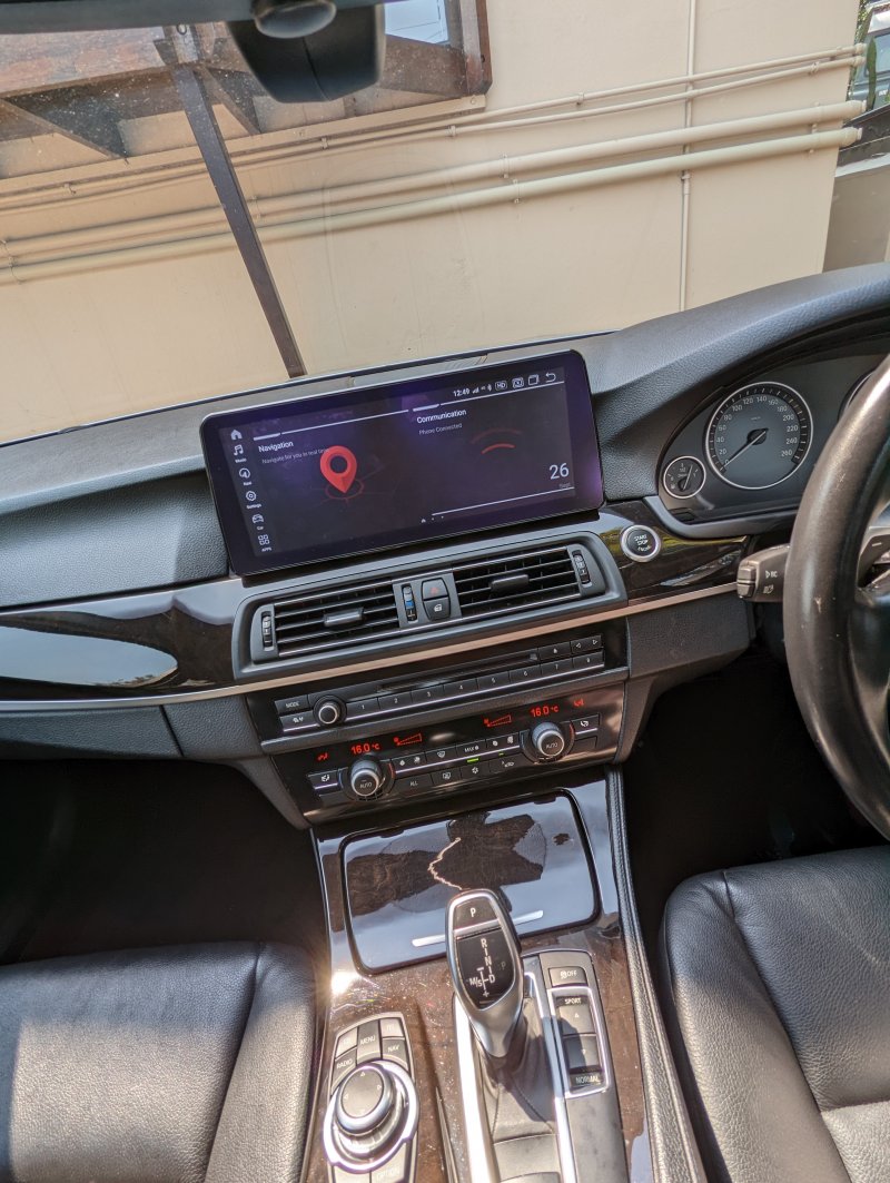

Update: everything is still working well, the rattles have not returned, so all is well!
It does get quite hot if it's in the sun for a prolonged period of time. Although it hasn't caused a problem yet, I don't think it's great for the longevity of the unit.
There are still occasional bugs where the wireless android auto doesn't work, and I have to plug my phone in, but overall still seems a great decision
Got the one that replaces original screen. Had it since 2021, works like a charm, no issues.
FILV
@hansi06 Seems we have the same radio.
Did you perhaps see if the deck has its own Mic? Or does it use the cars original mic for calls?
No one can hear me with phone calls, so im trying to figure out how the Mic works
FILV
Ok i think i figured out. I went to the actual cars bluetooth config, paired my phone. There after when taking calls via the Android deck issue solved (y)
