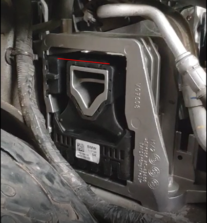

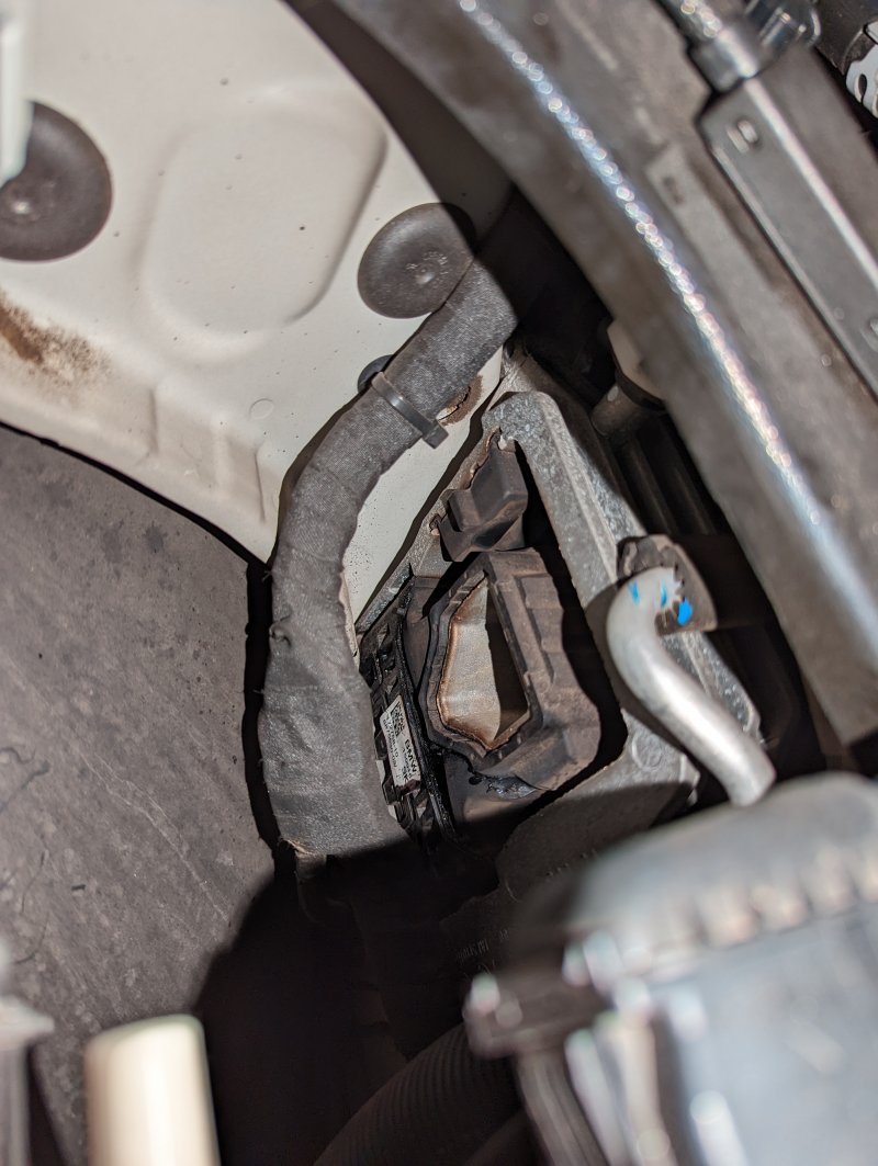

After searching for common faults(wanting to check everything before the motorplan expires), i found that the engine mount near the drivers side was notorious for failing.
To test it out, put the car in drive, press the brake pedal with 1 foot and then the accelerator with the other. If the engine mount is defective,you will get quite a big vibration/shuddering through the cabin. You can also ask someone to look for excessive movement of the engine when doing the same procedure.
Alternatively, you can look visually for any leaks or collapsing of the engine mount.
The mount was replaced under motorplan, and the ride quality improved immensely, with everything being much smoother. I guess the mount fails gradually and slowly worsens without the owner realizing the change in ride comfort.
