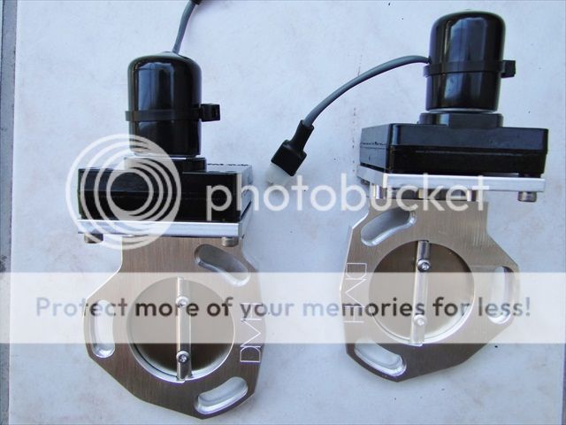

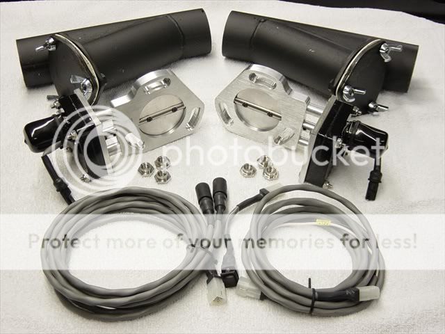

E. THE DMH DUAL E - CUTOUTS WITH FLOWTECH'S 2.5'
The cut-outs can be ordered to fit various exhaust sizes from 2.5', 3.0', 3.5', 4.0' The vital specs of the cutout-outs are:
• CNC Machined 6061-T6 aircraft grade aluminum body
• .375 diamiter 316 Stainless Steel Shaft
• Torrington Needle Bearings for years of trouble free service
• High torque gear motor
• 4 year replacement warranty!

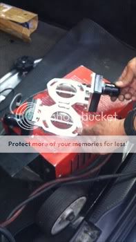

A close-up view of the cut-outs and the plug and play 16GA Belden wiring harness on the right. Notice the small black rocker switch on the cable which is only .75" X .50". You can order the wiring to your requirements. I needed at least 2 x 3 meters due to the wiring route from the back of the exhaust into the cabin. This is important because you do not want to fall short on the length.
F. FLOWTECHS 2.5" or Y-Pipes
You can order the cutouts without the flowtechs/Y-Pipes. I would recommend this because the DMH flowtechs were too heavy for our purposes. Keeping weight in check was paramount. So we custom made our own light weight flowtechs and could bend them to fit in the allowable space.

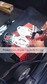

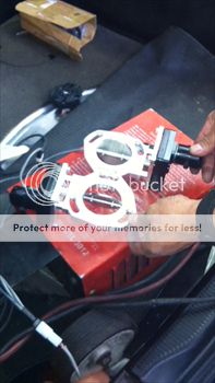

The cut-outs were bench tested on arrival to make sure everything was in working order. It was fun to play around with the new toys as well as refining our exhaust diameter measurements to ensure a proper fit of the cut-outs:

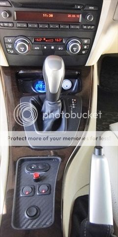

H. IN THE CABIN
One switch rule them all. This is the last part of the install but I am putting it first because I love switches, lights and gauges that tells me what is going on with the car. This switch has a huge convenient factor. In the past you had to shuffle under the car to open or close the cutouts. Now you can simply press a switch (the one @ the bottom) to open or close the cut-outs. You can hear the cutouts open or close when holding the switch down for a quick 3 counts or 1 second. You wont be able to hear it whilst driving though. You can also press the switch briefly for a partial opening of the cutouts, if you so wish - the noise is still the same but the exhaust tone changes when partially opened as oppose to full blast.

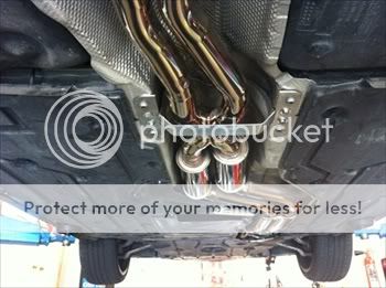

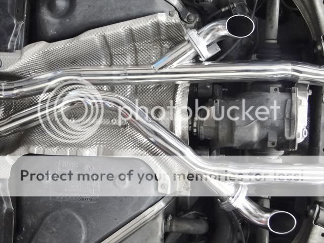

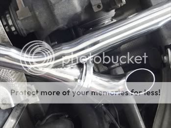

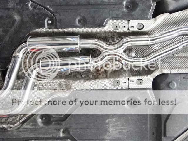

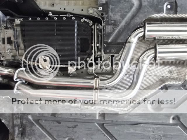

I. ART DPs & Midpipes
These DPs are based on the Rissracing 3' DPs that was first installed on my previous 335 but we refined the pipes for better fitment as well as tweaking the flanges and positioning of the lambda sensors. All the flanges used in this custom exhaust uses the "AR Design" bomb proof gaskets. They really great in preventing leaks.

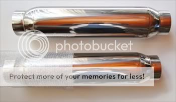

I initially imported two resonators from Vibrant Performance in the US but these resonators did not fit the space available after we factored in space for the X-Pipe. So we sourced two resonators from Powerflow and were lucky that they fitted the space as well as working perfectly in reducing drone and excessive noise when the cut-outs are closed.

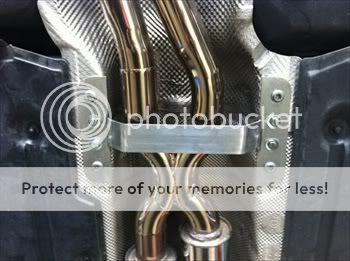

In the picture below you can see (on the right hand side of the pic) that our custom brace must still be fitted.

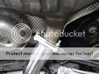

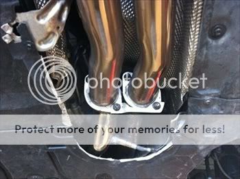

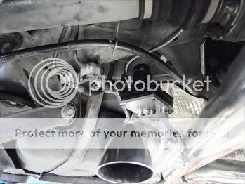

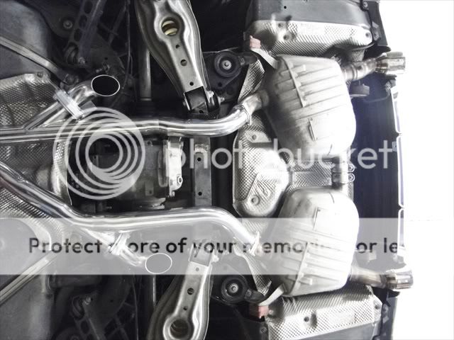

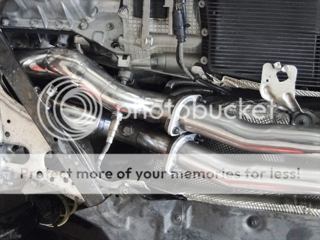

J. CUT-OUTS INSTALLED
Our own custom made flowtechs with adjustable down-turns and 1/4' thick flanges. The down-turns can rotate 360 degrees. We decided to point them downwards to the ground yet pointing to the back of the car, to create a vibrato, rumbling & echo effect as the sound reflects off the ground. In the pic below on the left you can see we took caution in attaching the cut-outs wiring away from the hot exhaust to rubber or insulated piping that does not relay heat.
The BMW performance rear mufflers/boxes. The BMW mufflers only flow 25% more than the stock 335 exhaust but the sound from these babies on a stock exhaust in the higher rpms is really exciting with an exotic pitch. But after installing the cutouts the sound from the BMW performance mufflers are totally different. The sound is deep, loud and uncivilised but with a unique rumbling character that forms deeper in the lower rpms. And as you build the rpms so does this sound increase into a boom. The lovely crackling sound of the turbo car exhaust is also amplified when you downshift.

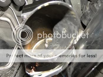

Closeup of the inside of the cut-out. The pic on the right: We fitted flanges to the mufflers for easy removal. The original "joint" for the BMW performance muffler has a slip on clamp, which is not very secure and can easily leak when the exhaust shifts. This problem is now solved.
After some run-in time, the exhaust changed into this stunning golden hue colour. Notice the joint between the DP flanges to prevent vibration or the flanges from touching. On the right: The stock brace was replaced with a custom brace which cleared the bigger mid-pipes.
