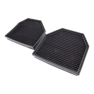

Genuine or BMC for me
I had BMC in my F10 - it offered no real advantage but given OEM prices (even after discount) it made sense to go this route.
Alfa 4C has a BMC filter as an OEM available option (It came on the launch editions) and was fitted by Alfa still under plan.
The issues arise when you over-oil the filter when cleaning or oiling it and immediately refitting it. I've never had issues using these on other cars in the past.

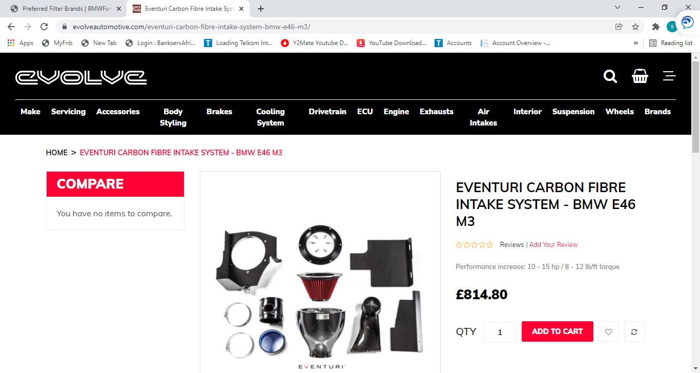

I am hoping for a lotto win so I can fit Eventuri intakes onto my F90 one day LOL... if not I won't hesitate to go the BMC route again when out of plan.
TurboLlew
eish Llew :(
$2300 for the F90 :cry: :LOL:

On the oiling Llew, a tech once advised me to just clean the filter and not oil it at all as the oil damages some sensors. However I'm a bit sceptical on that as the oil clearly traps alot of dirt.
I had missed this til the thread was bumped. A filter designed to be used with oil has a significantly larger pore size. If you don't like the oiling process, rather go with one of the dry filter options (there are a few - even from the same manufacturers sometimes for this preference).
The correct process is to clean and dry thoroughly, re-oil, blot the excess oil and then still leave it overnight... almost nobody does this (and a workshop might not have the time to realistically do this for an ordinary service).
