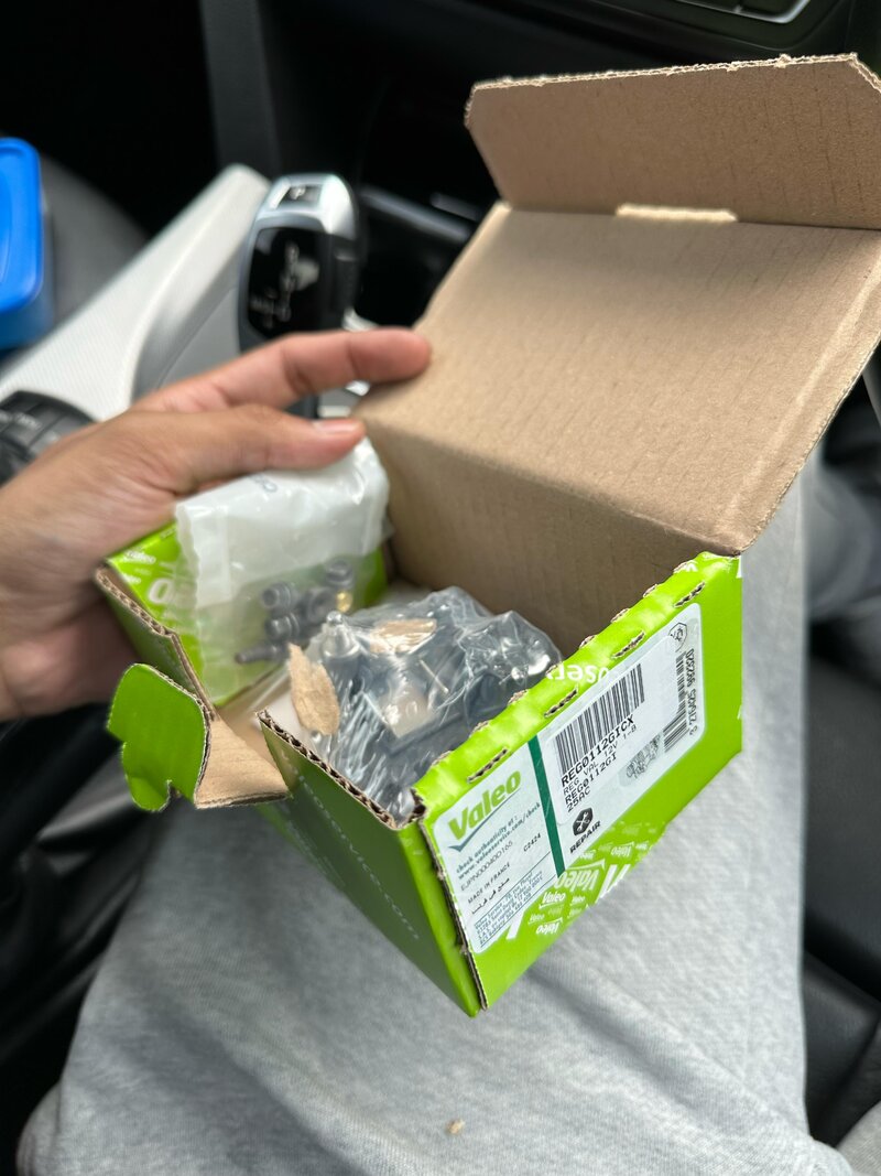

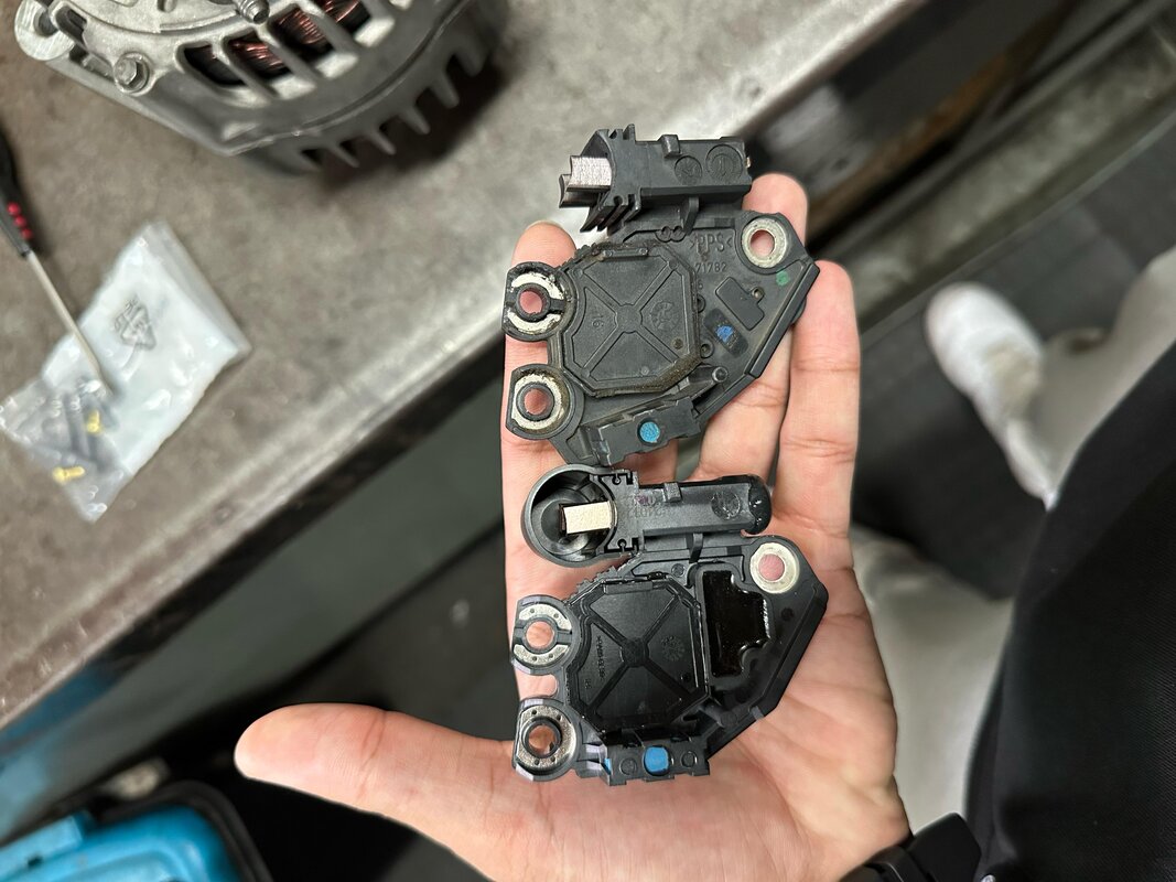

I went to Caelex in Pretoria and got a new voltage regulator for the alternator on my n47d20.
Honestly, I don't fully agree with the whole "current spike" thing, unless you're buying a voltage regulator that's made with cheap materials. In-fact it is a worn/failing voltage regulator that causes voltage spikes which in-turn causes current spikes (Ohm's law)... Save yourself the wallet-damage and chest-pain by buying the voltage regulator and fitting it yourself, it's a 30minute job to take out your alternator, replace the voltage regulator and re-fit the alternator.
I think I paid less than R600 (I asked politely for a discount) for my voltage regulator a few months ago and I have not had any battery related issues since then.
Side note: Caelex has a machine there that you can connect your current voltage regulator to and it will run a test to determine if it is indeed the voltage regulator that has failed. Take our alternator with when you go, just for peace of mind.
Honestly not sure why more people haven't heard of Caelex, their range for electronics is so broad.
New Voltage reg. - Valeo brand
Top - Old voltage reg.
Bottom - New voltage reg.

will try and find someone alittle closer but if I don't ill have to pop by them wish i attempted this myself before purchasing a new one thank you so much.
