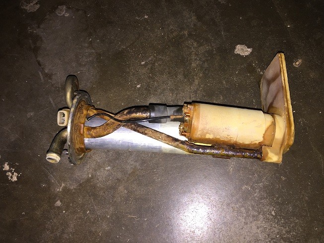

Car has spark and turns over , The internal fuel pump was not running , I tested it with a light and it was receiving power . I haven't tested the external pump though .
What I found , removing the internal pump , I found alot of rust around it , and on the pipes , the pump is clearly dead . The Tank is half full of petrol.
I also found dirt in the tank as well as a little surface rust around those areas where fuel was not present .
Before installing both new pumps and filter , I want to have the tank and lines cleaned and washed and (de-rusted?) Maybe replace the rubber fuel lines as well . ( Fuel lines are original so im sure they must be a little degraded? )

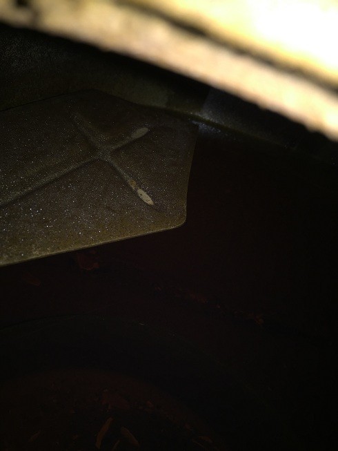

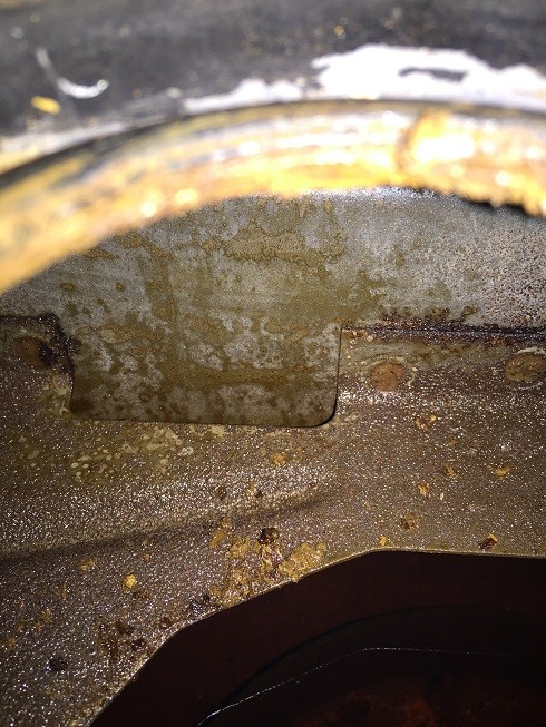

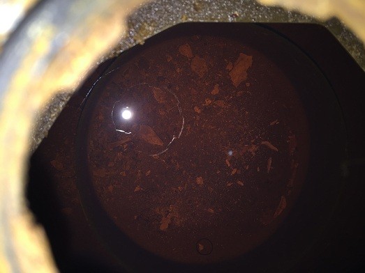

Here are pictures of the tank and pump . Tank is also very dirty , (no leaks though)
Pump is still a mess even after I had cleaned so much of the rust of it.
Tank still has 97 leaded petrol in there! Does petrol go off? Does it go stale? I don't plan on reusing the petrol , Just curious .

@ Luis Malhou , yup tested it , that in tank pump was soo rusted up , it was dead beyond belief , no noise no buzzing , Thats the reason why I purchased a new pump , but it looks like I would need to find a new holder for the new pump as well . Did your 850i stand parked of for a long time as well?

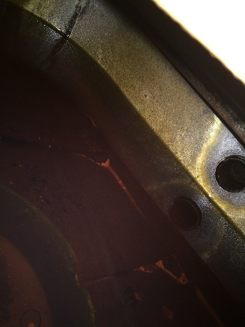

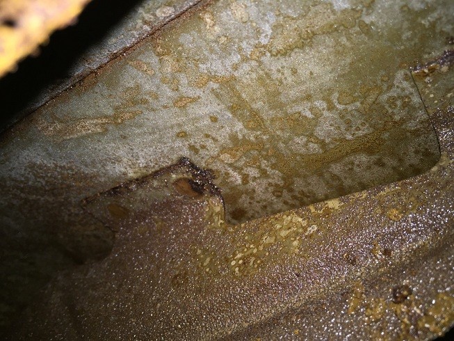

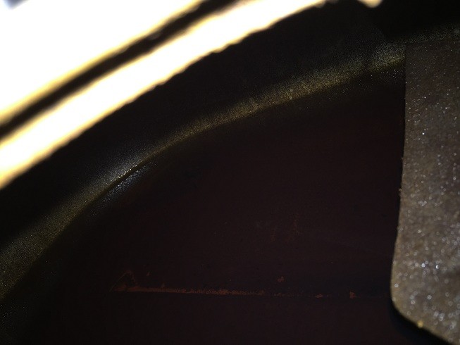

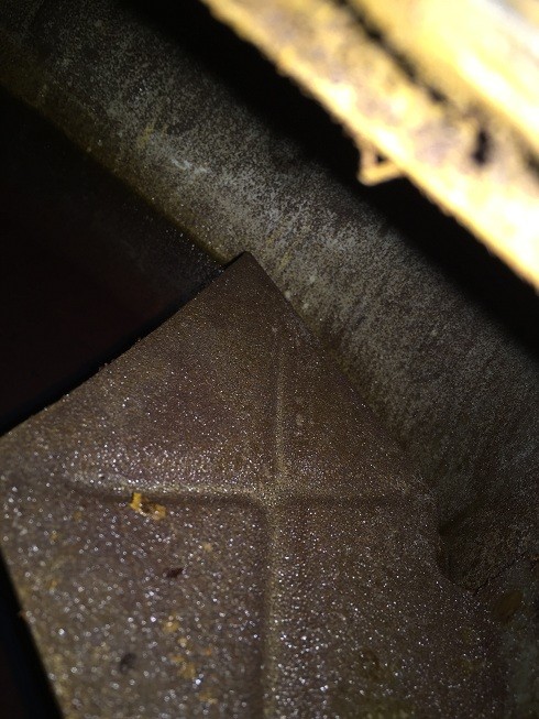

I took a few more pictures of the fuel tank , tried stuffing my phone down there but it was a little to big .
I had taught about buying another tank and just fitting that on but its so hard to find good E30s out there these days , I have a few leads on a few tanks but am not sure of its condition or if the older metal bumper tanks would fit on the later plastic bumper E30s .
How many meters of rubber pipe should I buy? Im going to order them from BMW , they did ask me how many I would need , I had a blank face lol
Here are a few more pics of the inside of the tank , Does it look bad? That is the original leaded petrol , maybe mixed with a little bit of unleaded (I occasionally threw in a liter or two while the car was sitting )

@wikked , Yeah! im def going to remove that old petrol , I had a look at the tank again an the internal filter that I removed , This stuff thats in there that I think is rust , seems to be a fine powder like material , brown in color , Also I was told that when rust reacts with copper / Brass , it turns green , The fuel pump pipes are they made of copper / brass? This isnt green , Im going to try and polish and repair the pump instead of having to find a new pump fitting , as Iv already purchased a New bosch replacement pump for it. Will post up pics when im done.

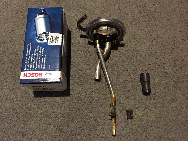

Iv cleaned up the old transfer pump . Attached a picture below , I will attach this new Bosch pump to it to replace the Original VDO pump that was there .
It had heavy layers of some sort of sediment , that broke up in my hand revealing the metal below.

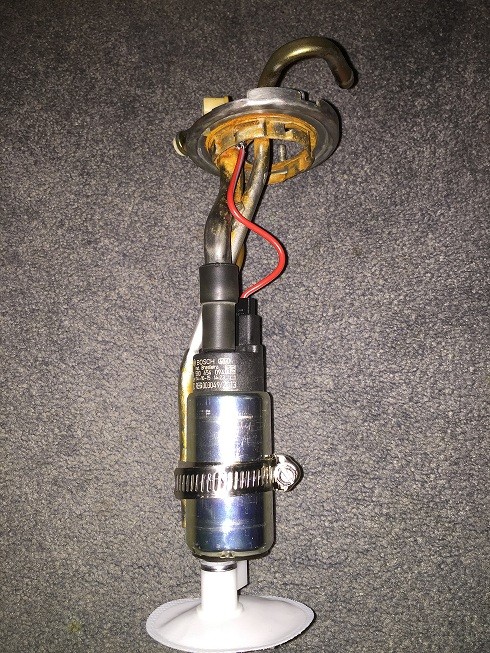

Just thaught I would update, Rebuilt the fuel pump , Hopefully I did it correctly . Next step will be to find a good garage who would remove the tank and clean it .
BTW , Once I have the tank removed , should I replace anything ? I know the Propshaft has to come off , When BMW replaced the gearbox 8 years ago , I had them replace the propshaft coupling and bearing , Now that its been sitting for so many years , should I have it replaced again?
New Rebuilt pump :)

Wont be doing that ,The pump was out of the tank , So thought I would get the project going by rebuilding the pump with the new pump .
Next step will be to have the tank removed , lines cleaned or replaced and then only will I fit the new part in .

As per my previous post , I rebuilt my in-tank fuel pump and purchased a new external fuel pump. Decided to test my Original external pump and it still works fine so I cleaned that up and reinstalled it .
