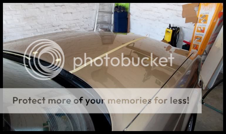

The polish for the day was Chemical Guys Pro Polish, doing two passes per panel using a medium cut pad with minimal pressure.
This immediately returned a huge amount of gloss onto the paintwork and as you will further into the detail the clarity was fantastic.
Here is a quick 50/50 with the left being before and right after correction:
Crystal clear paintwork, with lovely depth and gloss. I could not ask for more!

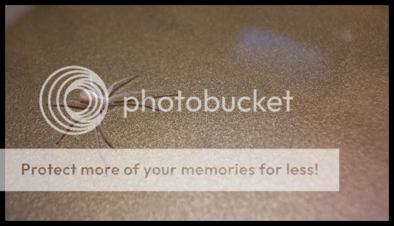

Like the Porsche the wax of choice is Collonite 746, a wax with a once year warranty from the manufacturer. Two coats were applied to the car and buffed off straight away leaving a beautiful finish.
Although meant to be a picture of a little 2cm spider I loved the paintwork captured. Notice the clarity I was referring to? You can see each and every metallic flake.
