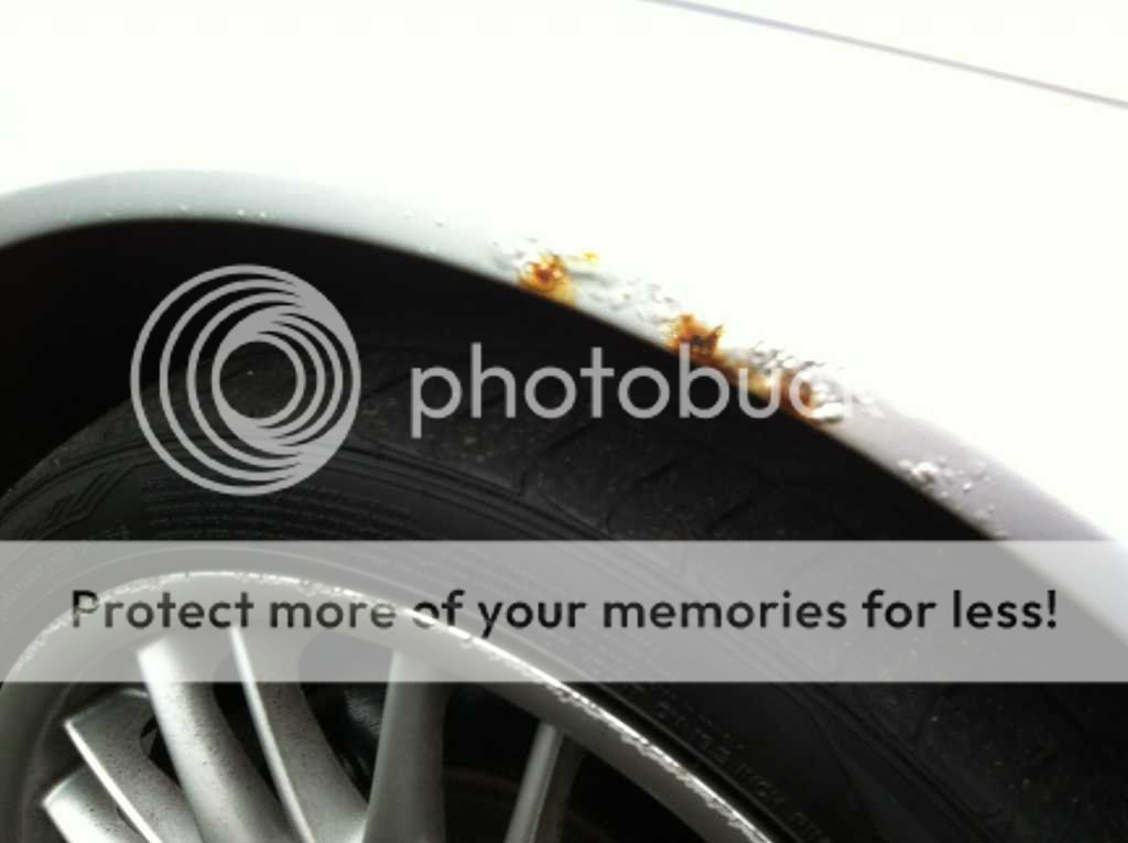

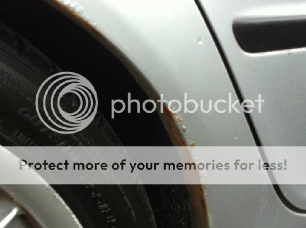

The pictures are quite deceiving. There is actually alot of curbing, and there is rust on all the wheel arches.
The car drives ok, not great though. It seems to pull the left while coasting and the right when braking. There is slight judder on pull away (felt through the clutch pedal - is this perhaps a dual mass flywheel?). There may be play in the shifting mechanism as it struggles a bit to get into reverse. Clutch may be slipping, because I was expecting abit more in terms of acceleration. The right front wheel is wearing on the inside - which is ok, but why not the left too? Airbag light was ON! Looks like the water pump has been repaired cheaply. Light blue compound around the valve cover seal - perhaps gasket sealer? The car was serviced 6 times - roughly every 20 000 miles - originally by main dealers then some random places. Cruise control works, as do the other functions I checked. Although I did find this:

also would suggest the 130i,also a 330d but you said you dont want one,but maybe worth it too have a look anyway.i would avoid any car with rust,as its costs alot to repair,

too may things wrong with that 330i... the pulling could be Rear Trailing arms but with the rust and possible accident damage i would not even consider it...

@Moranor: Yeah, I have to agree with you on that. It is truly horrendous! But good to see where things can go wrong. I keep going between the 130 and 330 in my mind. Especially when I start looking at one's a little more expensive.
