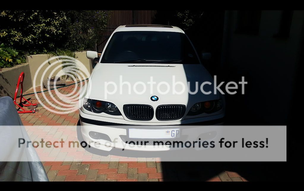

So here is a descent shot I got of how the lights look when the sun hits them at just the right angle with the painted cut off plates!
Mixed with a camera flash to pick up the light in the shadow. This is pretty much what it looks like in the flesh, well as close as I could get it anyway.
I am really loving the aggressive look this has given the car. I need bright white angel eyes now to compliment this look!

Howzit, I used high heat Red spray paint, got it from a normal hardware store, I think there is a pic of flames on the tin, DO NOT USE the engine enamel spray paints, they only withstand 300 deg celcius, the hot spot of a xenon projector where it meets on the cut off plate is much hotter than 300 deg celcius and the engine enamel burns away very quickly as I discovered with my first application where I tried a metalic blue paint.

Thanks :) You need to spray the cut off plate, so you take the projectors appart, and the little metal plate that gives you your cut off beam needs to be sprayed on the side that faces you if your looking at the lights from outside the car. I will try find some photos of exactly what I mean and show you. but it is pretty self explanetory once you take the lights appart :)
