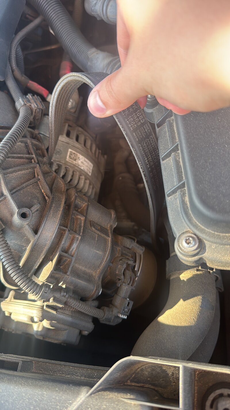

Any help or advice would be appreciated. I picked my car up from the car wash today and as I was leaving I got an alert saying my battery was not charging. I pulled into a parking bay and took a look inside the engine bay. Realised my crankshaft pulley belt was loose (yay). Maybe I shouldnt have pulled it to confirm, but alas.

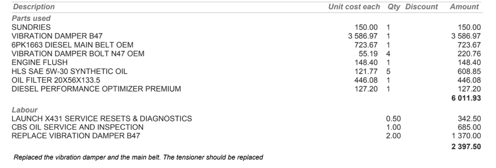

EDIT/Follow Up:
Had the work done at Brilliant Mechanical Workshop in Claremont, they were super friendly and helpful. I called at 17:00 as they were closing and they Whatsapped me to get more info after 17:00 so that I could come in the morning. Had my vehicle towed to them by ~09:00.
They ordered a vibration damper before my car even arrived( to speed things up at my request) since I was pretty sure it was the issue and they agreed based on the photos. I did a service at the same time, and they had my vehicle ready for pickup by 16:30 that same day. They repaired the damper, replaced the belt and did the oil service I was also due for (unfortunately they could not get the tensioner delivered on time, so they did not replace that but said it still has a little life left in it).
All around, they did an awesome job, were very friendly, and put up with me pestering them because Im a very curious person :censored:
Screenshot of invoice (for anyone in the same situation as me in the future):

I don't know much about the dreaded crankshaft pulley issue you refer to, but based on the condition of the belt, in the single not-so-great image in your post, which looks undamaged, I would think the most likely suspect is the tensioner pulley that failed and threw it off.
It will have to be towed in unfortunately - which by now I am sure you have arranged - but the scope and cost of such a repair is not significant, unless other damage was done.
There are of course other possibilities also and I'm a casual spanner jockey so I would advise you to look up a proper mechanic for an honest assessment.

Completely forgot to add the odometer! Thank you.
Yeah, was already stuck on the phone for a while and just wanted to get home so the photo is pretty crap. Im taking it to a workshop tomorrow to get looked at.
