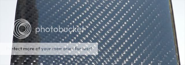

CARBON FIBER CASE
Higher engine temps equal lower battery performance. Braille's exclusive Carbon Fiber Case protects the batteries internals from high temps and provides the longest service life. Don't settle for a metal case that conducts heat, be cool.

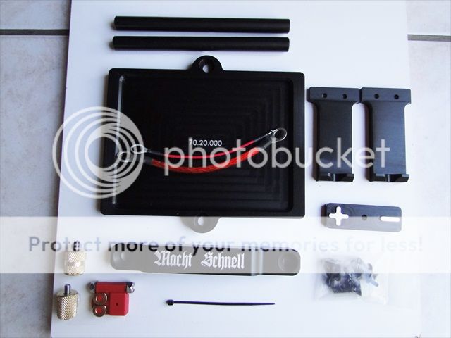

ENCLOSURE:
However a smaller battery footprint means it will not fit in the same location without fabricating your own mounting solution.

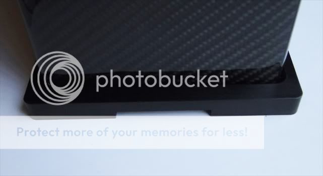

Macht Schnell Battery Enclosures are CNC-machined from the same aerospace 6061-T6 lightweight billet aluminum and feature a black anodized finish which is strong and non-corrosive to withstand grueling conditions while keeping your battery worry-free. Your stock BMW battery can be easily swapped at any time.
Other Features:

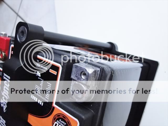

- Overall footprint are exact dimensions of stock BMW battery, engineered for a perfect fit
- Holds battery securely in place
- Top-mounted terminal indicator can be reversed for left/right positive terminals
- Macht Schnell logo engraved in holder
- Weighs only 1Kg

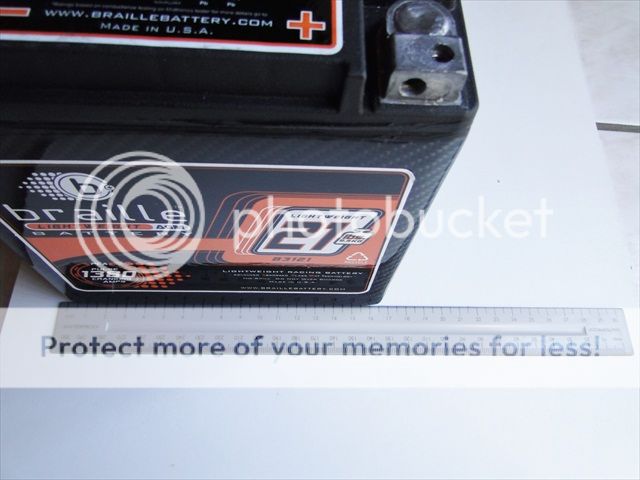

So I had time to check the Physical Specifications
Length: 16.5cm
A different perspective
Width: 12.5cm
Height (without enclosure): 17.5cm
The height of stock battery is 19cm

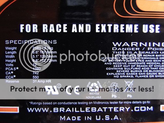

Minimum Weight: 9Kg
Weight with enclosure:10.1Kg
Compared with my 120d battery:
22Kg vs 9Kg
