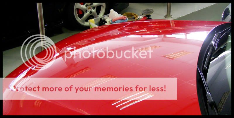

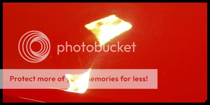

I didnt take any before photo's, however here are a few of the damages on the paintwork:
Loads of heavy swirling, sever contamination (paint felt like rough sandpaper) and a lack of redness were what I had to begin with.
The paint was given a good seeing to with Megs Paint Cleaner which left a smooth and soft finish. The paintwork then received two hits with Chemical Guys Pro Cut 2 polish removing about 90% of the swirls but leaving me with a very hazy finish.
This was solved with a few passes of Megs Compound X and waxed with Chemical Guys Pure XXX White Paste and topped off with some Wet Butter Wax to give the red some flavour.

Looking at those pics of the damage on the paint it looks as if there is some minor oxidisation on the paint (maybe its just the pics) which seems bad for a two year old car. Maybe the quality of the paint from the manufacturer is getting worse, not unlike black E92 M3's which has one of the worst finishes out there.

The paint was rather oxidized, and extremely coarse.
Felt rough and appeared hazy.
I dont think the issue lies with the manufacturers paint quality but rather with the dealer prep.
Preps like Auto Armours 3 in 1 make claims of huge longevity etc, yet only really last 2 or 3 months on the car. Often thrown in as a free extra car owners are under the impression their cars paint is protected etc.
Meanwhile the paint is slowly wearing and this is the result.
Waxes should be applied every 6 months at least, and most products that state they last a year do not.
